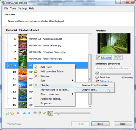

| Chapter text format allows you to choose 1 of 4 ways to label the thumbnails in your
chapter menu. Chapter Text: Once you have defined your chapter points, by right clicking on the same photo you can define your Chapter Text which will be used as the title of the chapter thumbnail in the DVD menu: ![]() Type in the text and press ok. ![]() Looks like: ![]() Photo Comments: By double clicking on your photos you have added to your project you access the Edit Slide window. Here you can add comments to your photo slideshow as subtitles. On the final DVD you can activate your comments via the Settings Menu or by pressing the subtitle button on your DVD players remote control. If you select Photo Comments under Chapter text format, the title of your chapters in the menu will be the subtitle comments you wrote for that picture. ![]() Looks like: ![]() Time in slideshow: Will display the time in which this particular slide will appear in the slideshow as the title of the chapter thumbnail in the DVD menu. You can see each time for each chapter point in the the photo list: ![]() Looks like: ![]() Chapter number: Will display the chapter number as the title of the chapter thumbnail in the DVD Menu, i.e. Chapter 1, Chapter 2, Chapter 3, etc. Looks like: |

Chapters – If “automatic chapters” is checked this will set a chapter point at every xx minutes and xx seconds (02m00s). If it is not checked you can still add chapters manually by right clicking on your photos and selecting “Chapter” | “add Chapter marker”. If you have already added automatic chapters you can still add custom/manual chapters. You can also change the time at which you want your automatic chapters to be placed and this will not change your manual chapters (which are not attached to a time, but to a photo). Automatic chapters are not saved as a setting when saving a project.
Automatic Chapter markers are a grey color ![]()
Manual chapter markers are an orange color ![]()
